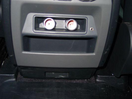

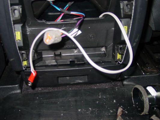

                                                11th October 2009, 08:24 PM
                                                #4
					You may as well stick a cig connector it the back whilst you have the center console out.
