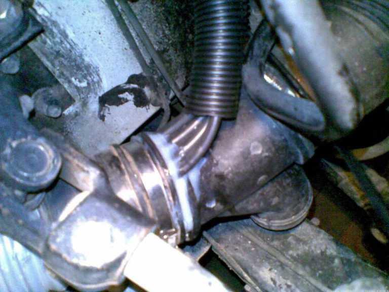

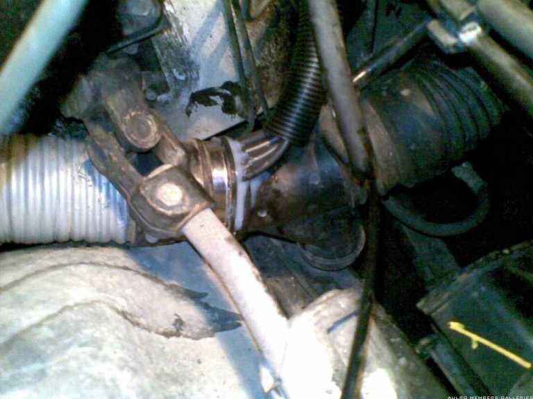

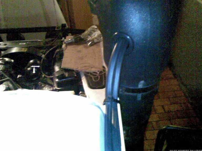

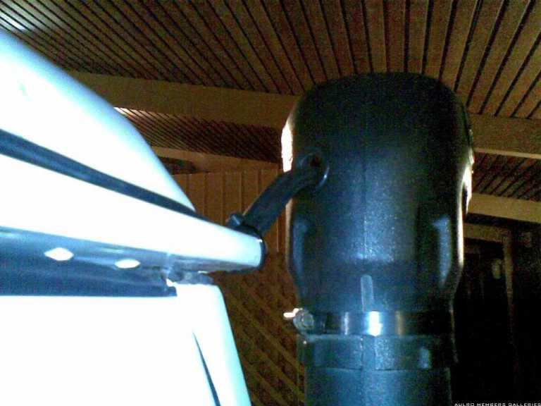

    Here's what I did in the end
    Ground the lip off the bottom hose and squeezed the wires between the two and filled it with silicone
    At the top I just drilled a hole and put a rubber grommet in
    The light bar and lights will be ready on Wednesday, so hopefully it should all be together by the weekend

    Just one thing; if you do end up putting them in the bottom hose where I did. Make sure to put some tape over the edge of the solid hose. It has a metal insert that could rub through the wiring if you don't
    You'll see what I mean
