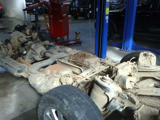

    Don't the 2.7TD models need the body removed to replace the turbo?
    If so - I would either stay away from that model or make sure the turbo is in A1 condition.
    Removed from what? There is no separate chassis. Do you mean remove the engine to replace the turbo?

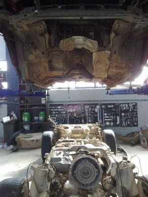

    D3 has a composite chassis: a ladder chassis and the body has a monocoque chassis bolted together.
    You undo some connectors and lift one off the other. Not too difficult. But the dealers have worked out how to replace the turbo without lifting the body.
