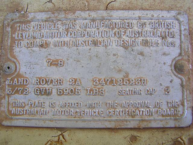

    I have a trayback that is a 2a and the plate on it says 7/71 from memory. I was wondering how much longer they made 2a's for
    It has a perkins engine and series three type guards and 2a bonnet hinges and no salisbury diff.
    Thanks and Regards Mark

    The Australian compliance plate is affixed when a built vehicle is dispatched from the manufacturers holding yard to a distributor and frequently does not indicate the actual date of manufacture/assembly.
    The last 109" SIIa before the first SIII 109 in the Grenville books is 35201458H and this vehicle was delivered to the original customer 25/09/1972.
    According to Classic Land Rovers VIN calculator the H suffix was in use from February 1971 to End of production in October 1971.
    AFAIK the H suffix related to SIIA vehicles which had amongst other things Salisbury diffs in the 109" wheelbase models. (Contrary to John's comment, the Salisbury rear diff is listed in the Jan 1972 SIIA Parts Catalogue (Part No. 608024 - first issue) in section 08.67 and described in the contents page as "Rear axle (interim)" all the components are the same as the SIII models. In the mid 1970's I had one of these late 1971 SIIA suffix H vehicles with a Salisbury diff and AFAIK I was the second owner and first private owner.)

    Thanks Diana, that explains a bit about my IIA ute in that case. When I googled up the IIa production run dates last night it indicated the change over from IIa to III was in 1971, but I knew this is what I had under the bonnet. It was complied 6 months after the last IIa produced.
    Simon,
    Vehicle 34712523H, engine no 34524020B 6 Cyl Chassis Cab, Salisbury Axle, supplied 22.5.72 in a batch to the Grain Elevator Board, Registration No EIC129, fitted with Dunlop RTM (Road Track Major) tyres, keys 916 and 701.
    Afraid the Grenville records can't help with anything else
