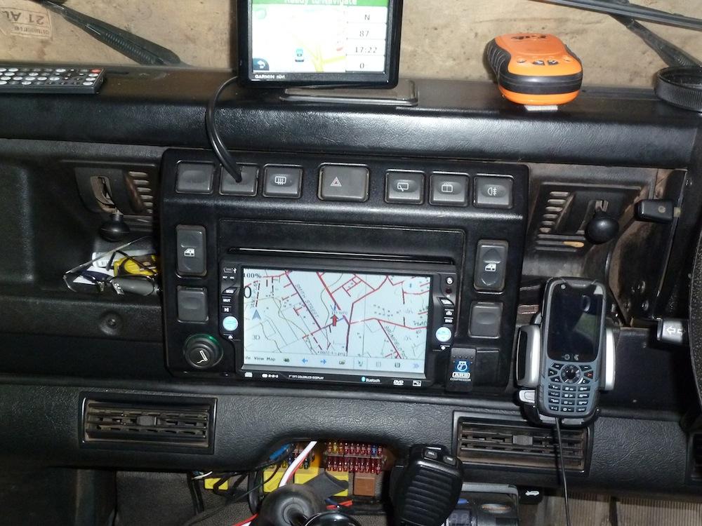

    I bought a Chinese OneDin unit off Ebay US $280 inc postage,
    If anyone interested PM me & will give the item no.
    Its a tight fit , something about a fish comes to mind.

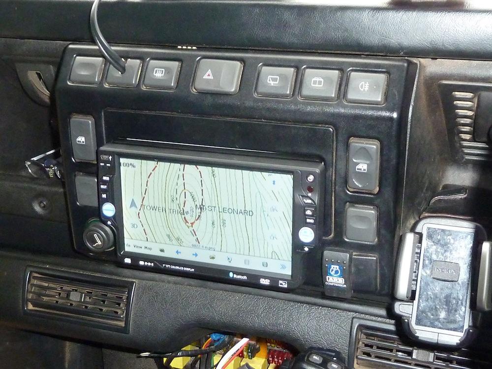

    All in All Bloody Good. 8gb SD card holds Oziexplorer plus all my Hema Maps & Vicmaps. The TFT screen clips in but I put some doubleside tape behind it as I wont be unclipping it & just incase I bump the eject screen button.
    Its way better that the $1000 piece of crap Hema/VMS GPS I had
    Put GPS antenna on guard as it gets better all round satellite view than on the dash. Reversing camera works a treat much better than the tiny 3.5" one I had to use reading glasses to see - makes trailer hookup a breeze.
    Ipod interface is great & it actually charges the ipod, most dont.

    Before Pic
    http://www.goingbush.com/landy/gps/before.jpg

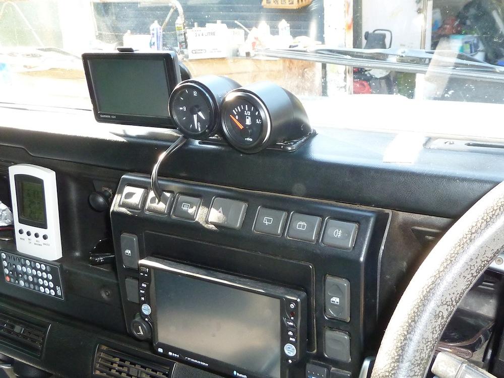

    After
    http://www.goingbush.com/landy/gps/after1.jpg
    http://www.goingbush.com/landy/gps/after2.jpg
    http://www.goingbush.com/landy/gps/after3.jpg

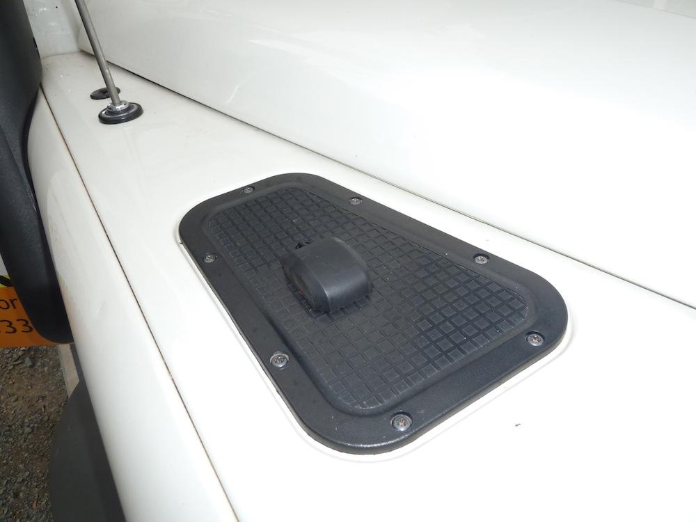

    Antenna
    http://www.goingbush.com/landy/gps/antenna.jpg

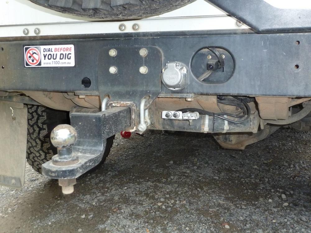

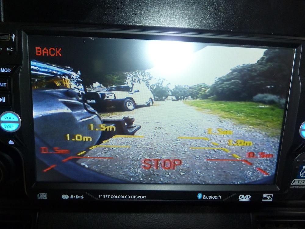

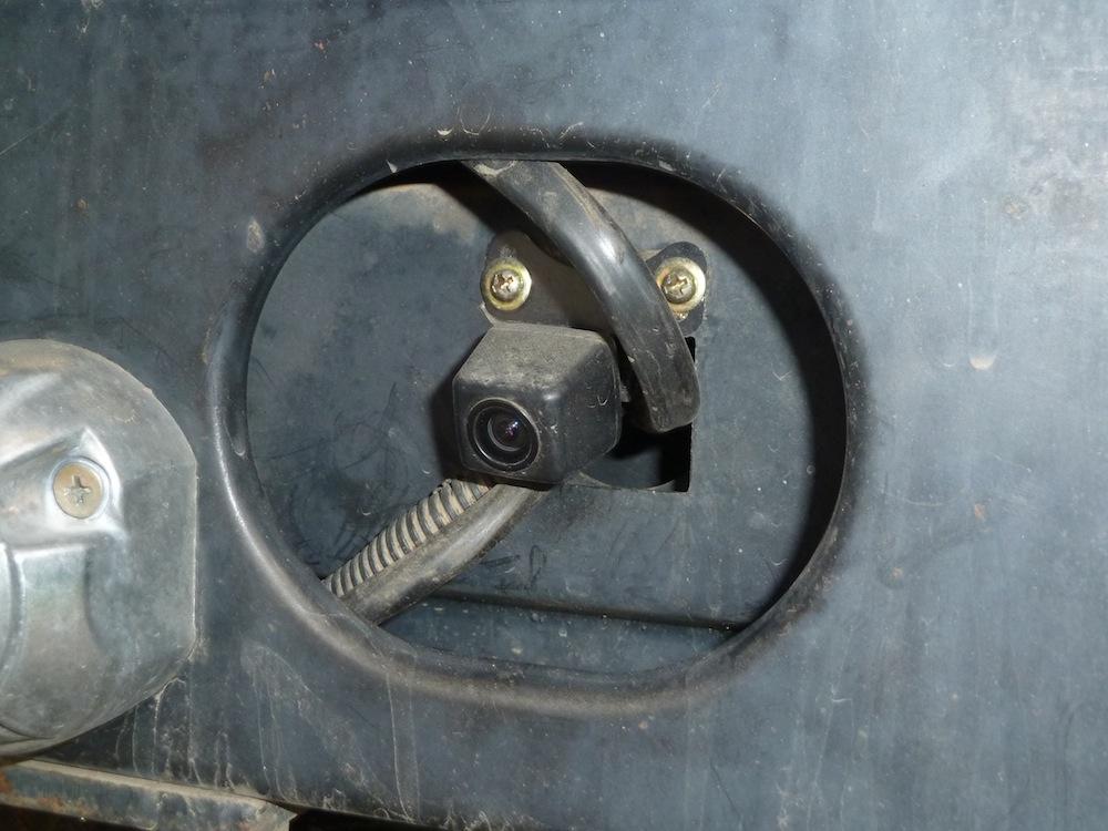

    Reversing Cam
    http://www.goingbush.com/landy/gps/cam1.jpg
    http://www.goingbush.com/landy/gps/cam2.jpg
    http://www.goingbush.com/landy/gps/cam3.jpg

    The bluetooth actually works very well, much better than the Garmin Nuvi BT, when the phone rings the Navigation cuts out & comes up with the BT screen almost instantly. The Garmin took about two rings before I could answer. I already had the reverse cam, have tried various ones but eonon (ebay) are good & waterproof .
