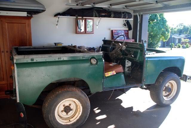

    I have been spending some time reading through posts by Banjo and Isuzutoo-eh ans got motivated to update this thread.
    The shorty has now been stripped down. The chassis needs some serious work; rear crossmember, gearbox cross-member, most out-riggers, front dumb-irons and the front cross member has also been cut to accomodate the Holden engine.
    Not having access to welding equipment, I would have to pay to get the chassis repaired a galv chassis from the UK was looking a better option, but the cost was a bit scary.
    With the roof off:
