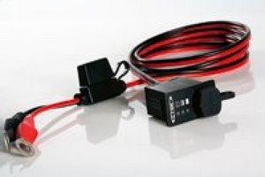

    Hi DriveSafe - I've got a quick question if you know anything about the CTEK "Comfort Indicators".
    They indicate the level of charge with 3 LEDs (green/yellow/red); attach to the battery permanently; have a quick connect to a CTEK charger. Cost me $25. Makes it really easy to see the level of charge and easy to re-charge as you don't have to lift the seat to get to the battery.
    This is a link: http://www.batteriesdirect.com.au/sh.../ctind382.html
    Anyway - I was wondering how much they themselves actually flatten the battery by monitoring the battery and flashing all the time.
    The 110 only gets driven once every 3 or 4 weeks, so is this thing actually discharging the battery itself, or is it so negligible that it is irrelevant?

    Hi David and sorry mate but that is nothing more than a glorified voltage monitor.
    As to how much power it uses, this info should be supplied with any manual that came with the device.
    David, can I make a suggestion, I know it is a pain in the butt having to open the seat when ever you need to access the batteries but for what you want to do, I have 30 amp Anderson PowerPoles on a short length of cable connected to every 12v battery I have, both in the workshop and on my vehicles.
    I also have a number of multi meter test leads made up with the probes cut off and a set of 30 amp Anderson PowerPoles fitted to the test leads.
    With this set up I can do a voltage check of any battery using one hand instead of trying to do a balancing act with the meter and trying to hold the two probes in place.
    Furthermore, I have 30 amp Anderson PowerPoles fitted to all my battery chargers, so I can make a connection to any battery without messing around alligator clips.
    I also have 30 amp Anderson PowerPoles on all my inverters and just about everything else that is a low to medium current drawing appliance.
    Back to you gadget, if you use any volt meter to check the state of a battery’s charge, it only works if the battery has a small load connected to it while you take the reading.
    If you have it connected while driving, it will not give you the battery’s voltage once the motor is started, it will only show your alternator voltage.
    If the battery is not in use for some time, the battery can actually be totally stuffed but shows a good voltage level until you apply a load and the voltage then goes QUICKLY south.
    As above, you are far better of using a cheap digital volt meter and just learn how to use it to get the info you need.

    Thanks for all that! I actually have those exact same connectors to connect the battery to my fridge, or alternately a fluro light. Easy to change and nicely made. Bit tricky to poke the connectors down inside if you don't have the special "Crochet" tool but other than that easy to use.
    I found out a bit more info on the CTEK indicator:
    Green is above 12.7 volts
    Yellow is between 12.4 and 12.7 volts
    Red is below 12.4 volts
    So are you saying that even if the green is flashing - that the battery might only be over 12.7v but only without a load on it? What conditions would it be over 12.7v and not start the engine? We were hoping to use it to monitor the battery when running the fridge overnight and just unplug the fridge if the light went yellow or red. Bad idea?
    We only have a single battery in this car, and not enough time to organise a dual battery system before we leave. This was my quick and dirty solution.
    Here is the advertising blurb:
    CTEK Power Inc Battery Chargers - CTEK56382
    Don't be kept in the dark about the status of your battery's charge! CTEK's Comfort Indicator lights up w/ all the information you need to keep your battery healthy and fully charged.
    Features:
    • Works w/ all CTEK 12V Comfort Connect chargers
      • Easy-to-use system allows you to plug in charger without first removing indicator
    • Allows quick-glance access to your vehicle's battery-charge level
    • Simple, traffic-light-style display demystifies charging "mumbo jumbo"
      • Green: Battery is in good condition and does not need to be charged
      • Yellow: Battery should be charged to avoid damaging stratification
      • Red: Battery needs charging to enable restart
    • Equips you w/ the information you need to prolong the life of your battery
      • Properly charged batteries last longer - saving you time and money
    Specs:
    • Application: all CTEK 12V Comfort Connect chargers
      • Chargers that have the orange oval connector
    • Model: 56-382
    • Eyelet-terminal size: 8.4 mm
    • Battery cable fuse: 15A
    • Battery cable length: 16"
    • Includes 1 battery-indicator cable w/ 8.4-mm eyelet terminals
    • 5-Year warranty
    CTEK Comfort Indicator wiring cables plug together w/ any Comfort Connect end plug and are compatible w/ CTEK Comfort Connect 12V chargers.
    The simple-to-read, traffic-light styling of CTEK's Comfort Indicator panels allows quick and easy evaluation of your battery's charge level.

    I'd put money on it the light would go Yellow overnight
