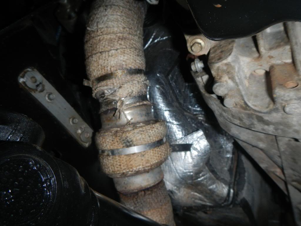

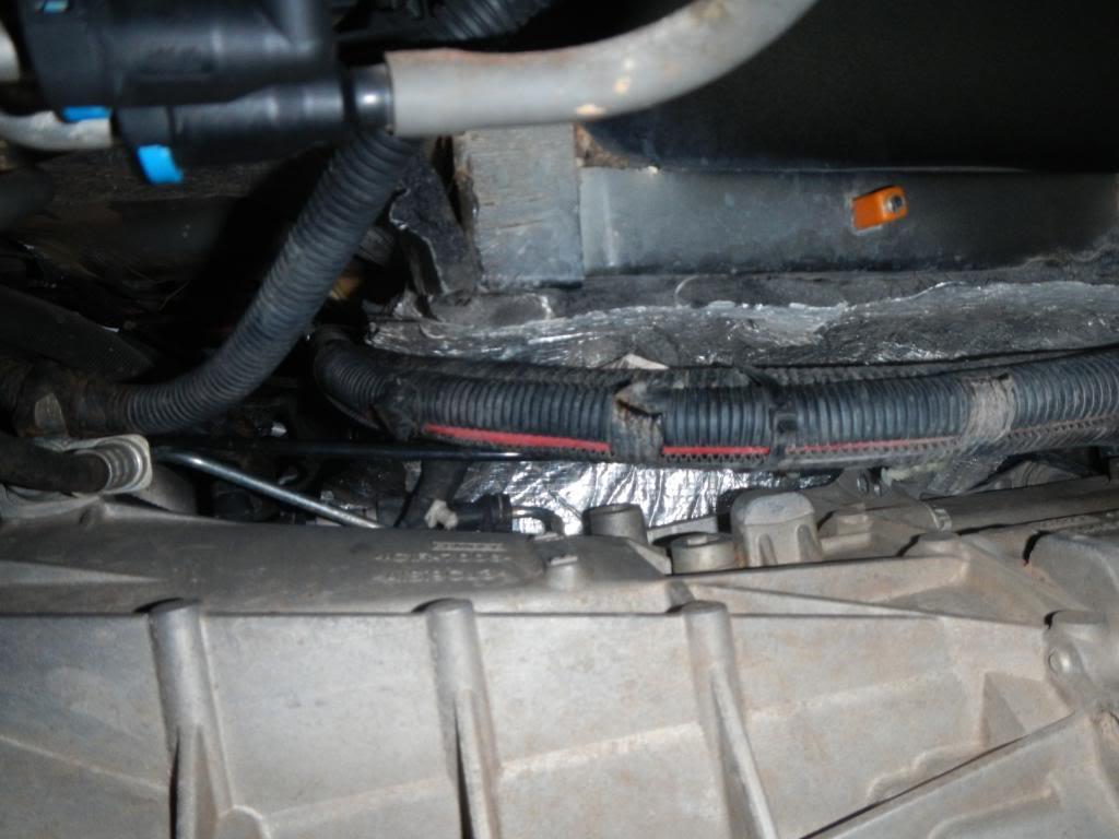

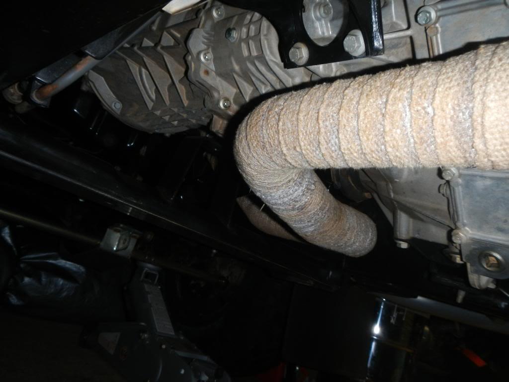

If you want to improve it here is what I did.
1/ lined the underneath the floor, seat box and transmission tunnel with a heat protective mat. See link.
Car Turbo Exhaust Muffler Insulation Heat Shield Mat | eBay
2/ Wrapped the engine pipe from below the turbo to the join at the centre pipe with a ceramic heat wrap.
Now it is very good stays nice and cool. Well worth doing makes it a lot nicer to be in during summer.
