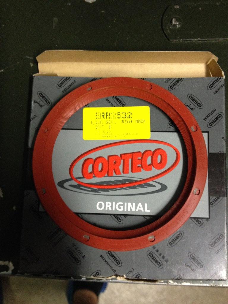

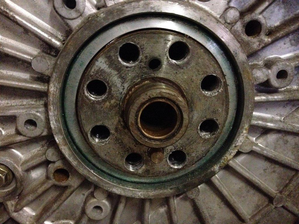

 The first picture shows whats installed at the moment, the second is a new and what I believe to be, an Original Equipment seal.
 Picture 1:
 Current 200Tdi Rear Crank Oil Seal by Jon_Kelly, on Flickr
 Picture 2:
 ERR2532 - 200Tdi Rear Crank Oil Seal (OEM) by Jon_Kelly, on Flickr

 As the current seal is not leaking would you leave it as is and tap the M10's in situ?  In doing this I am concerned about 2 things:
 1) that the current seal is on the visible side at least, made of Aluminium whereas the OE seal I have is rubber and much more like every other Land Rover seal Ive replaced in the past.
 2) That I won't get the threads started straight as nothing will be square.
 Tapping the M10 studs to accommodate the Stumpy bell-housing would be much easier with the flywheel housing itself on the bench as it will be easier to make sure everything is square and straight, but will obviously mean replacing the oil seal.
 Thoughts and advice please...
