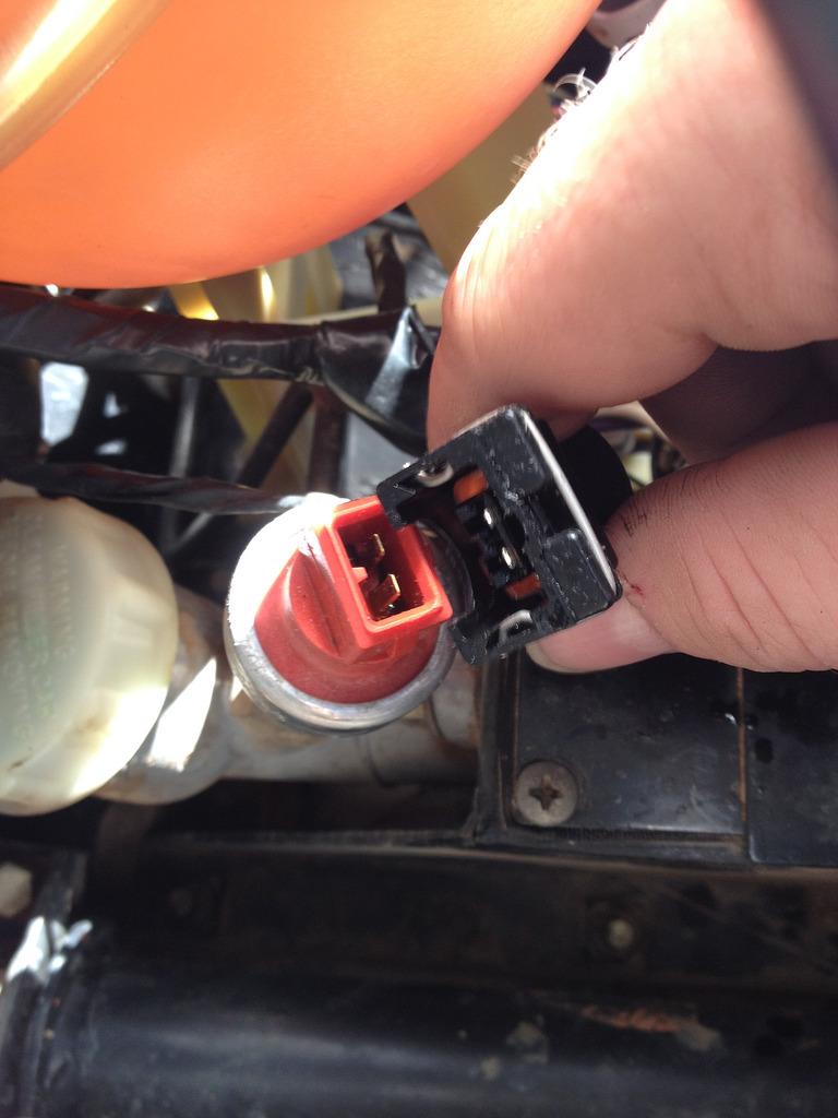

					Guys,
 My TD5 started over-revving when changing gear...  A quick think identified the clutch switch...
 I took the connector off to find the contacts sat in clutch fluid.  I removed the excess fluid, put the connector back on and the switch works fine.
 Any idea why I would have fluid in the switch contacts?  Is it possible for the switch to fail in this way?  Is a new switch the fix?
 Land Rover TD5 Clutch Switch by Jon_Kelly, on Flickr
 Any thoughts...
 Jon

			Eric
					Same problem discovered on my 2005 Defender.  I'm thinking about removing the switch and plugging the hole.  Maybe better to put a switch on the pedal.  Wonder if anyone has been successful with that idea?
