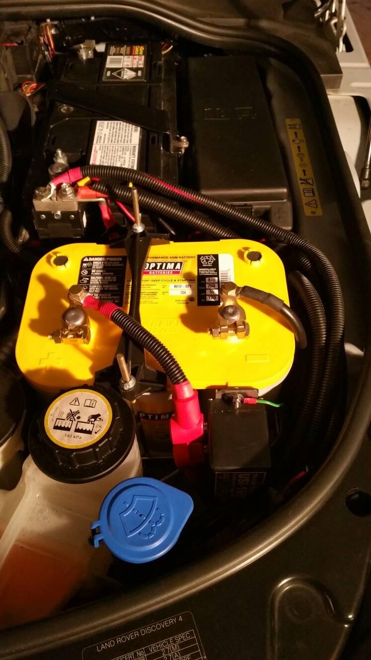

    So after far too long contemplating where i was going to mount this damn winch isolator, i gave up and just finished wiring it up without it.
    Just wondering how many of you did the same if not where did you mount yours?
    Also is it really needed? Has anyone heard of a winch powering up by itself? Or is it overkill.
    Anyway if it's really required I'll have to get some more heavy duty leads cut. Which will be a bitch... And probably require another 4 hours procrastination...

    I'd be fixing that left hand +ve connection on the main battery. Full flat surface connection.
    What winch did you fit?
    Cheers, Mungus.

    Ah true, seems to be on an angle. Just had to disconnect everything and remove the aux battery to connect the -ve. Runva Premium 11000...
    I tried several positions under the bonnet to mount the isolator and the only possible option i can see is beneath the battery isolator...Which may have enough room..
    Kinda wanted to keep the battery cover.
    Don't want to drill into the bull bar...

    Russrobe, I believe you just fitted the Summit bar. I'm fitting mine next week (myself) with the same winch. I believe the winch solenoid sits on a plate recessed from the top of the bar. Is there room on that plate to fit the isolator?

    Hmm good idea, i will have a look, because they'd already run the cables from the control box to the battery area for me, i didn't think to put it in the other end.. Makes more sense now you mention it.
