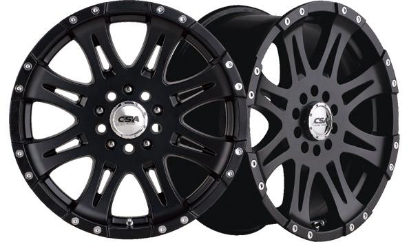

    20" CSA Raptors Rim on Discovery 4
    I managed to sourced a set of second hand a CSA Raptor rim since I had a damaged LR Rim, Bob Jane T Mart highly recommended it as well. Anyone else had this on? Any feedback? I don't want to risk another LR wheel since they are expensive to replaced, I Would love to have GOE 18"Rim but likely to have them later on.
    http://www.csadirect.com.au/wheel-range.asp
    Any thoughts?

    LR wheels have a brilliant double lip to lock the tyre bead. If you are going 20s and not 18 GOE's check out gumtree.. There are heaps of OE D4 wheels for sale in 20' and they have the correct 53+ offset also the correct load rating and are cheaper than new aftermarket rims that have offsets at around 45+ which with the extra inch in the 20' over 19's will have the tyres sitting out a fair distance.... A lot have them reconditioned. make sure it is correctly load rated D4 and not RR..
