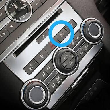

In the mean time - press the dash button.
Wich button Mike????

The button in the middle of the dash that kills the sensors

						The button circled in blue. The one I can't see on your picture.
Why don't you have one? You have the rear sensors don't you?
I know how to turn my sensors off,want Mike to realise all are not the same before he posts as if you are a nuffie
I guess you guys don't have the touch screen,if you have the touchscreen you have an option in there to play with the sensors.

MY14+ doesn't have the button if rear sensors only. I think full surround sensors get the button? As Andrew says, turn the sensors alarm down with the volume knob instead.
