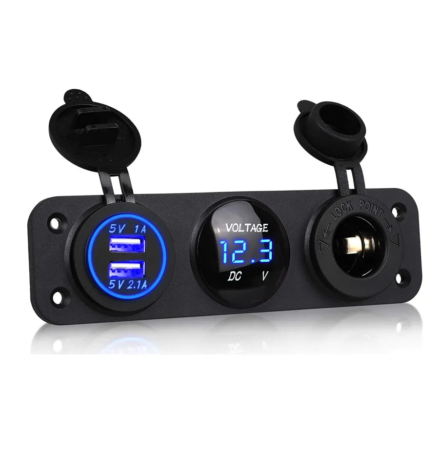

    Dave , is it just for 12V /USB or audio ? There are 2 orange connectors there that are for heated seats that you can use for power, a 3 socket panel will fit in place of the pocket.
    Where does this panel get purchased from?

    Quote Originally Posted by PerthDisco View Post
    That was just a random pic but lots on amazon.
