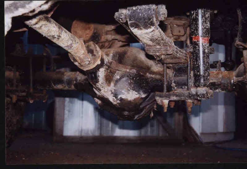

    A rolled front diff.
    Note the shaft angle and extended oil filler.
    Jan 2008
    Nowra NSW
    3,906
    If you look at the pics above carefully you will see a powersteering pump and a non standard exhaust with the normal leaking CV joints
    NOTE THE SPRINGS......they are not parabloic and are normal leafs.
    That would be the best way to improve ride and flex without big money.
