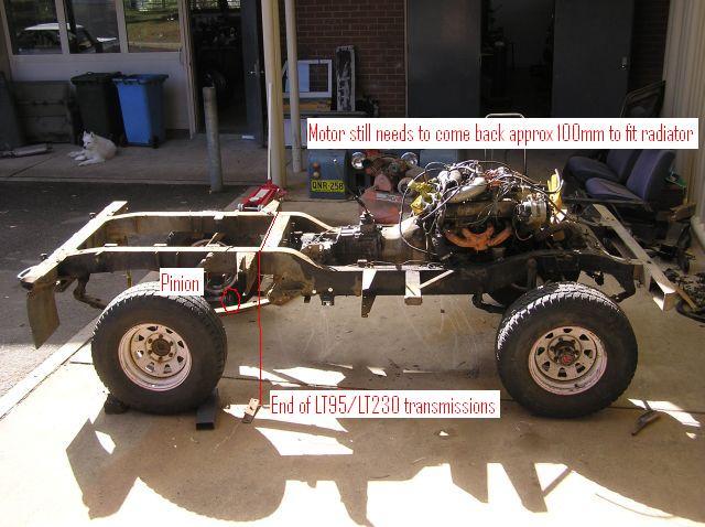

    The other issue there is the Ford C4 auto is very short, much like a series gearbox. If you run a disco ZF auto it will be too long and the options are to either push the lot forward with a Defender type nose or a run a rear propshaft which is about 20cm long if you push the motor and everything back into or through the firewall to keep the original fascia.
    I would guess that there is no easy optioneither short of adapting a 4cyl motor to the auto. That auto should be easy to get bits for.
    Surely it wouldn't be as bad as all that??? The 109 propshaft is quite long - especially with a rover diff - which it looks like the vehicle in question has. We are only talking about moving the engine back 12-18" or so.
