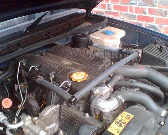

    TDI owners , how and where have you plumbed the oil return line ?

    Quote Originally Posted by loanrangie View Post
    13 mm poly tee into the OE breather return line - although having said that, the tee needs to be as low as possible as it will only just have enough fall. If the fall proves insufficient and the oil backs up, I'll have it brazed into the turbo line next service. I was hoping to find brass, but the poly seems to be coping.
    I've done 1,000 k and the oil is only just starting to form at the element inlet, so it won't be a major problem if you find the fall isn't sufficient for it to drain properly.

    Where is this return line, near the turbo or other side of engine ?
    It is on the drivers side. It comes out of the bottom of the OE breather and terminates about 150mm lower down into a fitting that is bolted to the block.

    Quote Originally Posted by B92 8NW View Post
    Thanks Joel, i thought there may have been something on the LH side apart from the the turbo oil line to tap into.
